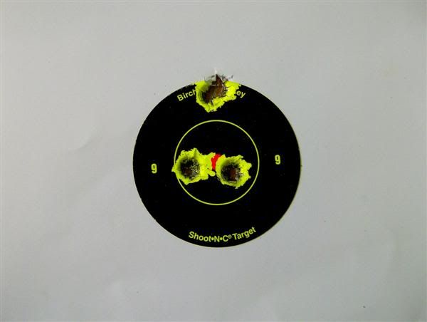

Right,got back from the range earlier and on the whole im happy with my reloads.Apart from one round which somehow i'd managed to under charge they were good.Only fired at 50mtrs because i just wanted to see what they grouped like and will be intresting next time im at Barton road.Recoil wise pretty much the same as Privi.

That is fine shooting for 50m, certainly I would be pleased with those results, were you using open sights and what weight bullets?

Good starting point, with some intelligent load development they should tighten up nicely. for the longer ranges.

Open sights and a 174grn Privi bullet.A fellow club member had a go and despite his scepticism with using a light load-he was impressed.ovenpaa wrote:That is fine shooting for 50m, certainly I would be pleased with those results, were you using open sights and what weight bullets?

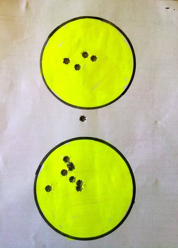

This is probably my best shooting i did a while back.Five rounds with my 1944 K98 (7.92) ,2" target,open sights,56 year old milsurp,but at only 25mtrs this time.Three rounds through one hole!

Nice one Steve - looking good
So you didn't 'try'..you 'did'
Let us know how the tweeks go......
