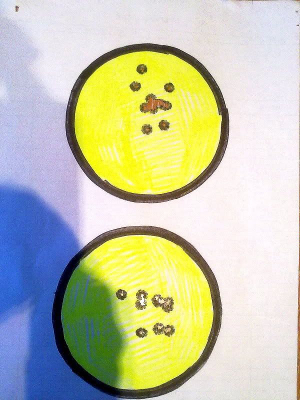

Tested more reloads this morning.This time they were full length sized and slightly more powder (35grns instead of 34.5).
Not as tight as before,but this might have been me rather than ammunition.
I'll have a stab at the Mauser next.

They are still good groups, did you build them any longer this time? What you need to do is find the maximum cartridge overall length (COAL) you can build is and then back it off say 30 thou (.020") to start with
You can use proper tools for this however an easy way is to take a case fired in your rifle and neck size it then cut a couple of slots in from the mouth to just in front of the shoulder, then de-burr and clean it up, then take a bullet and give it a wipe of case lube and push a bullet in so that it is just engaged, them chamber the case and bullet slowly, with luck the bullet will move back in the neck because of the slots allowing the neck to open slightly.
Open the bolt carefully and measure the COAL. Repeat the process.
Now have the look at the bullet, if it is heavily grooved from the rifling the neck tension is too tight and you need to tweak it carefully so it has less grip on the bullet. I use a permanent black market to mark the bullet so I can see where it engaged in to the rifling.
Once you have your COAL build an empty bullet to your chosen length make sure it still fits the magazine.
