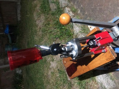

I have my PPM set up to fit on adaptors I made that push into powder through dies, it works quite well. There' an image hereabouts that shows mine.
I've just been reading up on the lee auto powder measure I may go down that route, especially for 38 loads.
The PPM is set up to throw 27 grains of lovex D073.6 for my 223 with 50 grain Barnes varmint grenades. The dies in the press are 357 magnum ones as I'm loading a couple of hundred tomorrow and will set it up first thing whilst the good weather holds.
