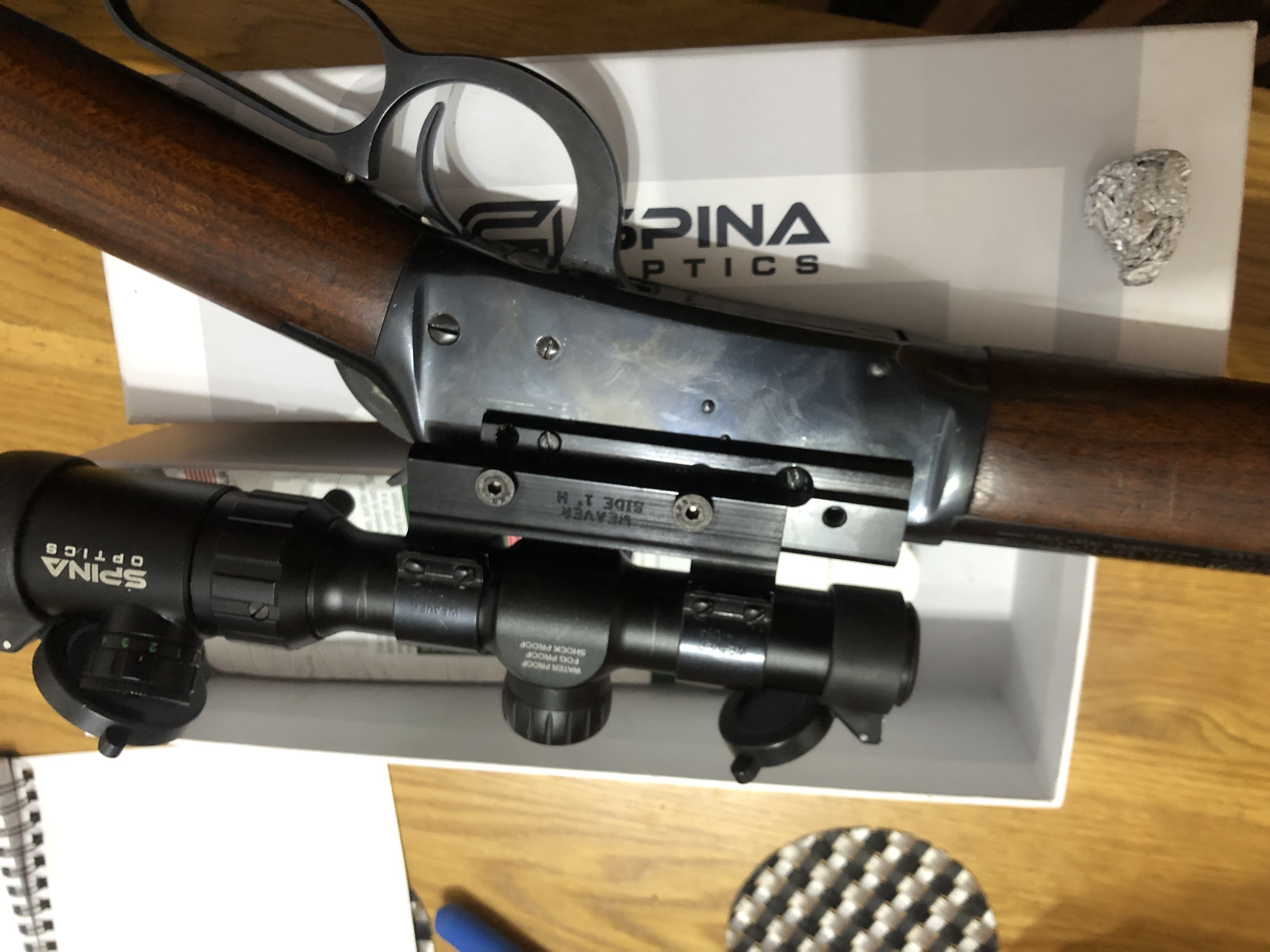

Got the mount, scope and gun connected up after a hiccup, sighted it in and I can shoot average 3 shot groups with it now. Because it adds just over a pound to the mass of the firearm, perceived recoil is much more tolerable.
Looks like the dogs dinner but the "normal" iron sights are there as a back up. In the end I bought another 1x4 with illuminated reticle, just a cheapo one that had reasonable reviews as the zeiss has a 30mm tube and the weaver fittings are for 1" tues.

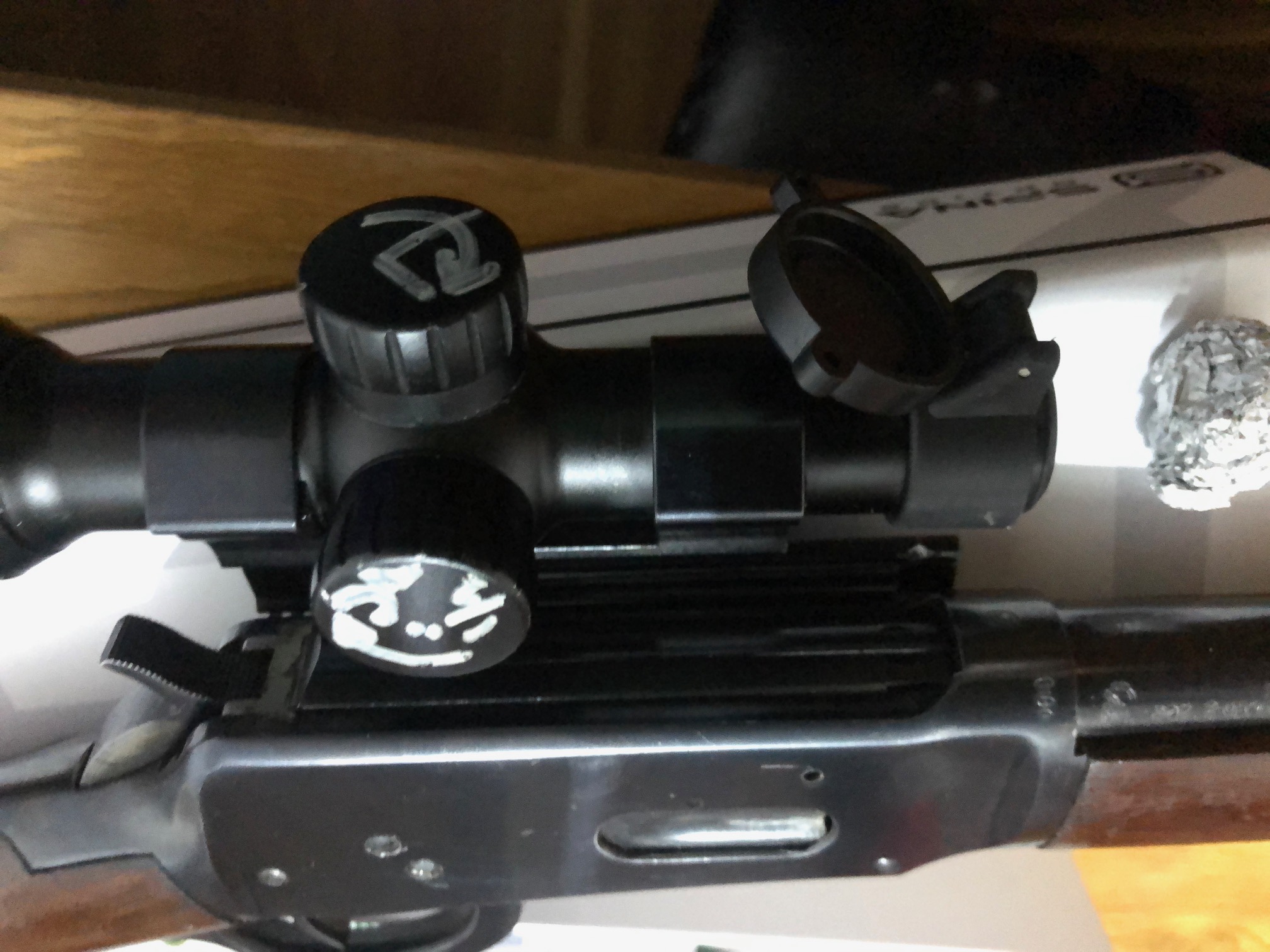

Ejection OK, performing better now I've used threadlock and the correct torque on the screws. I quite like it.
Biggest issue is that the scope has to be rotated through 90 degrees so the turret is out of the way of the cases as they go into orbit. Net result is the vertical crosshair, which has a Christmas tree below the centre, is now on the right. It's ok though as I haven't got a clue what the graduations are, I just have it printing about 2" high at 100 yds then it's all downhill, so to speak, from there.

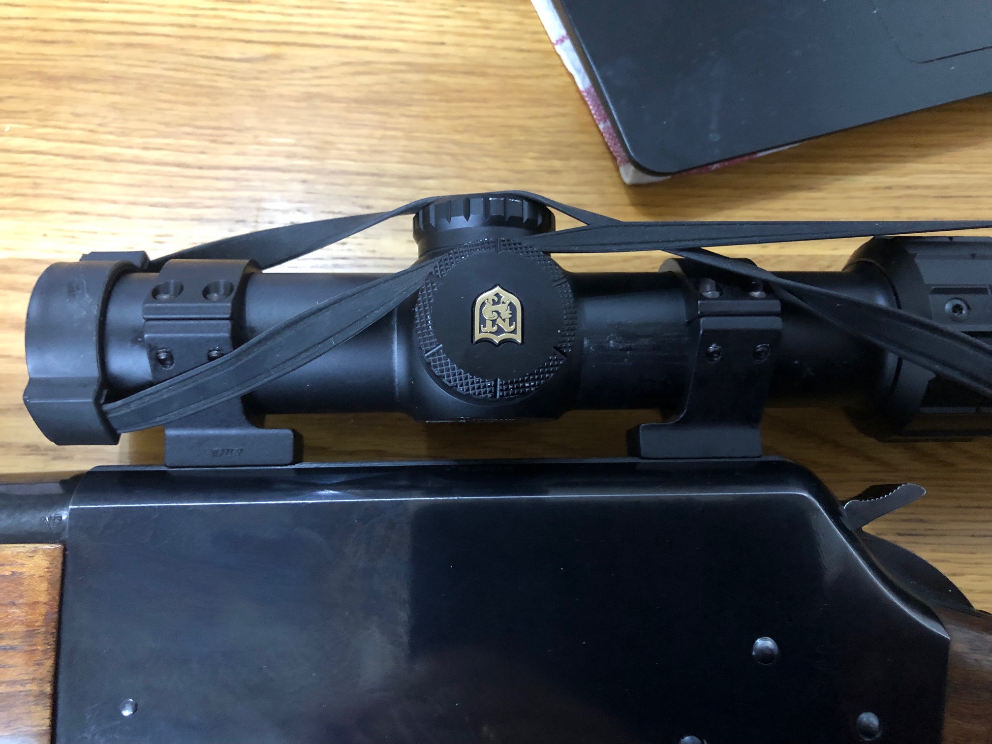

As a matter of interest I managed to get a set of Talley once piece rings for my pig gun,Browning 308 BLR, these have replaced a pic rail and weaver rings and have dropped the scope by more that 10mm. I had low rings on previously and these new low rings allow me to aim with my cheek on the stock which is a good thing.
There's an image hereabout that shows how neatly these rings fit.

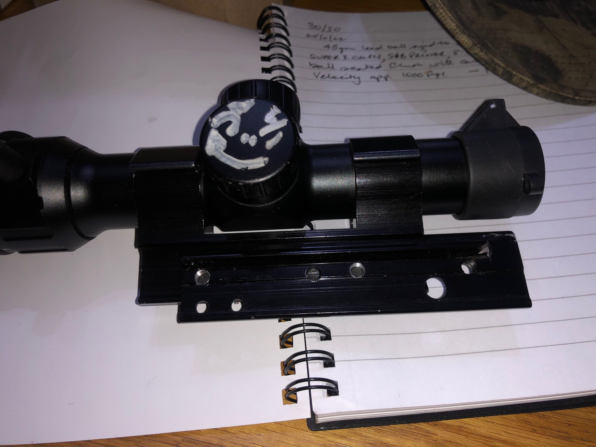

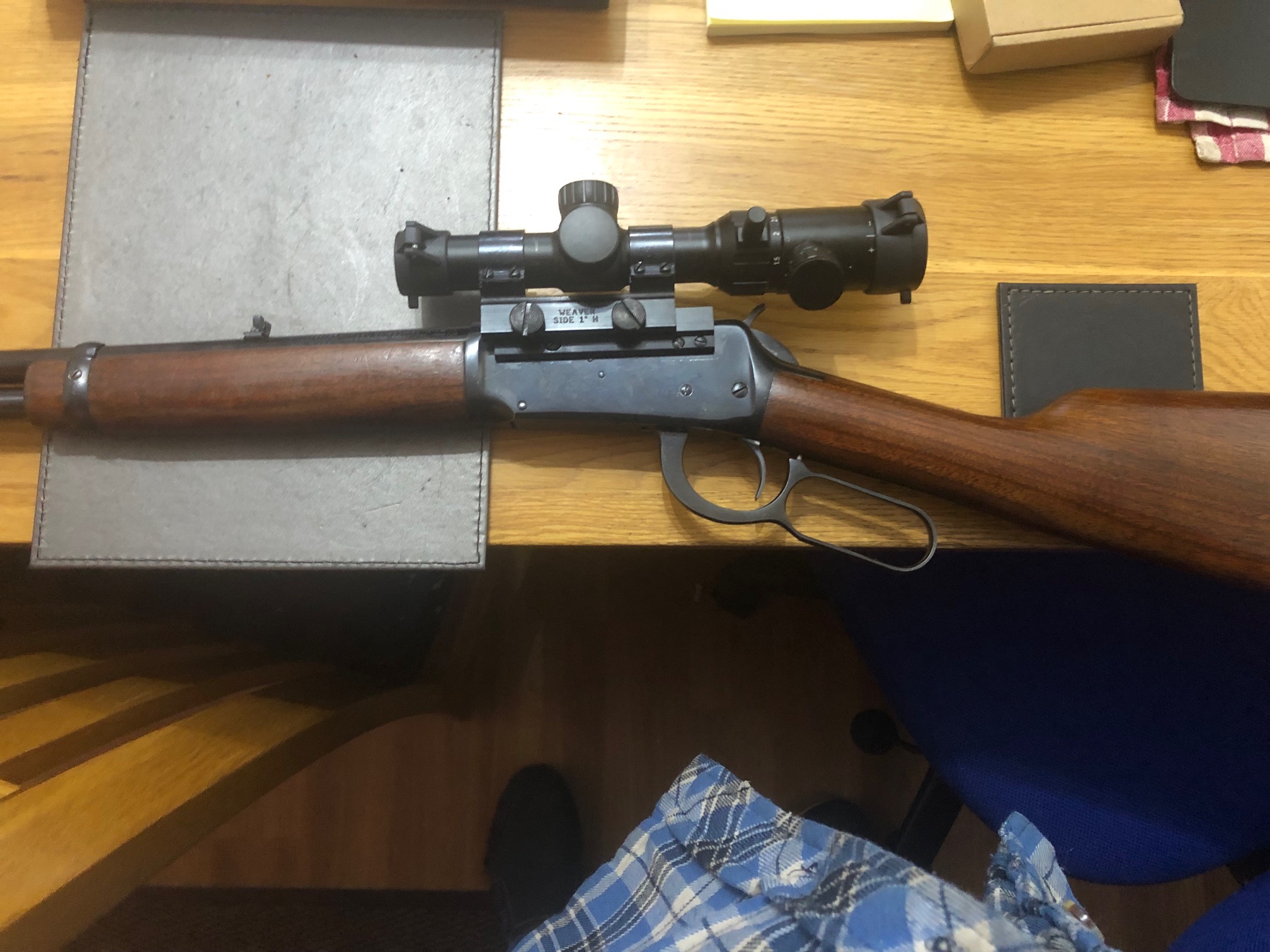

I gave the weaver mount a dose of thinking about, spent a little time with a ruler and decided that the scope mount can be moved back.
Drilled and tapped two holes, being tight I used unf taps instead of the unc weaver used but it all holds together.
Gun now ejects spent cases up, they hit the front ring and ricochet off to the side but most importantly, the scope turrets are in there correct plane, eye relief is much better, for me, and I'd heartily recommend it to one and all. Hope the images clarify what I've done.
