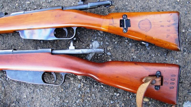

jjvc wrote:Dromia and i were at our clubs range day at Catterick today, and as we both had our Carcano's i thought i would take the opportunity of some snaps.
Both are in 6.5X52 calibre, Dromia's being the longer 91/38 Fucile Corto from the Terni Arsenal and mine being the short 91/28 Truppe Speciali, with the gain twist rifling, manufactured at the Gardone Arsenal.
My T.S. has the better quadrant sights but it was a good foot high at 100m, the 91/38 has the fixed battle sight.
Forend and bayonet bar differences.
The 91/38 has a butt trap for the cleaning rod.
Both brass and steel chargers.
Thats my first photo post folks, i hope you enjoyed it.
Sure did, they look mint , are those the oswald type ?
Joe
jjvc
Posts: 590
Location: Durham
Re: Carcano
#18 Post by jjvc »
The longer 91/38 in the post was the type used by Oswald db.
Joe
