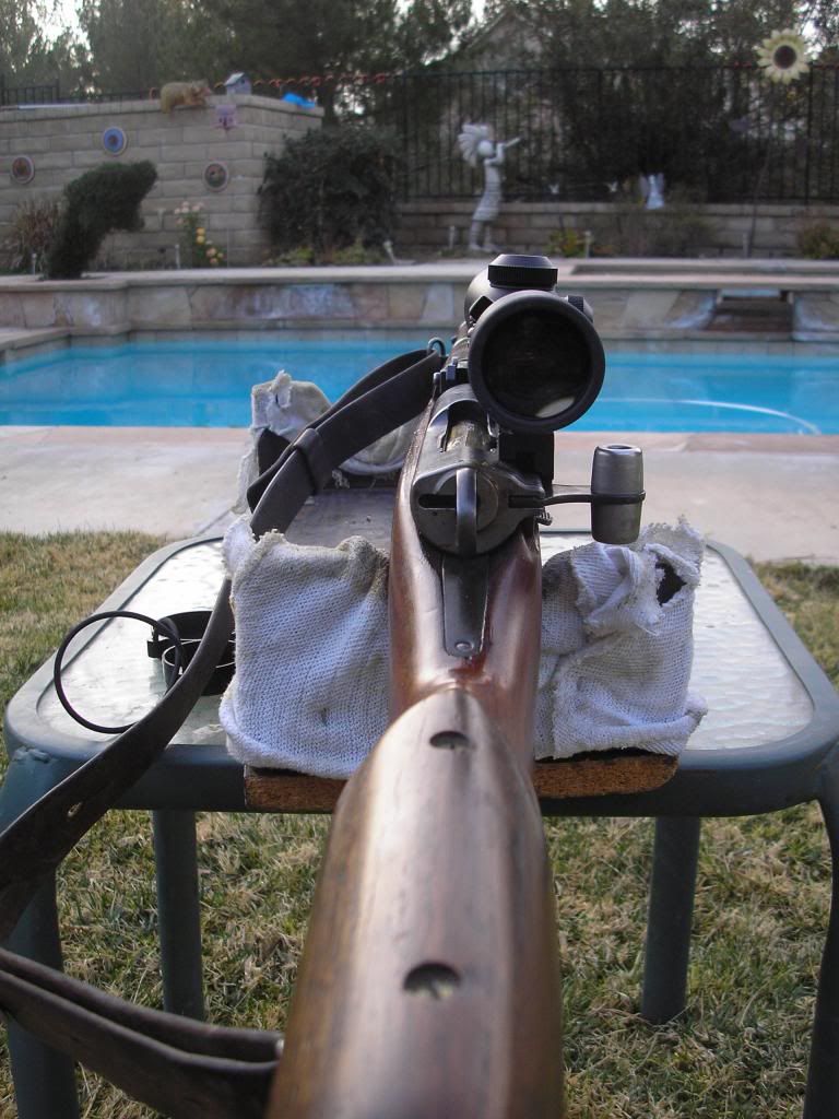

Re: K31 scope mount
That mount looks like its well over to the left.
Looks a bit cack handed/eyed/pawed!

Re: K31 scope mount
K31 mounts are offset to allow a stripper clip to be used for reloading. A benefit of this is that the iron sights can still be used.

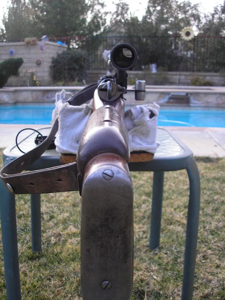

Re: K31 scope mount
the mount with the correct scope works fine, just stick with a simple 4 or 6x scope with a small objective lense and 1" tube and no side focus knob and the jobs a good 'un, my K31 is conditioned for Deer and AOLQ although to date I haven't had chance to use it for that.Zero at 100 yrds 3/4" left of point of aim, you will then not have to worry about horizontal cross over the POI will always be 3/4" left, and for closer than 100yrds you can just use the iron sights

Re: K31 scope mount
Here's how the mount looks on my K31. Seems ideal to me but then I shoot from the left shoulder.
