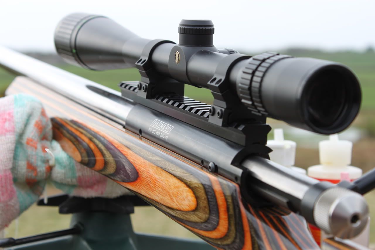

The rifle has a Picatinny scope rail mounted so my first job was to mount a scope. I left in a bit of a rush and just grabbed an old Bushnell Elite 8-32 x 42 scope from the shelves and a set of Picatinny rings. Of course when I got there the bloody rings were 30mm and the bushnell is a 1" tube. So I had to source so rings locally, finally got a set of Leupolds but as they are "better" rings they need their own special shaped allen key to fit the screws and naturally this wasn't with the rings. Don't get me onto scope rings and rails and lack of uniformity and interchangability :evil: .
Anyway with the aid of a near enough allen type head and a hammer I got the rings and scope mounted.
This where the first real issue came to light with the Barnard action. The action is extremely well made to very tight tolerances and is a smooth as silk. Up end the rifle and unlock the bolt and it slides gently out of battery under its own weight. To remove the bolt from the action is simple and elegant no catches just aligning the cut in the bolt with the sear and it slips out dandy. However to do this the bolt handle has to go over 90 degrees and I couldn't do this with the scope mounted to give me good eye relief. This was a real bugger for barrel break in as the bolt needs removing very frequently for cleaning 'tween shots, so I had to settle for less than good eye relief on the scope.

The problem with the action and the scope mounting still bothers me though, the owner has now mounted his own scope and has good eye relief and the ability to withdraw the bolt. Still its something to bear in mind if you are considering a Barnard action.

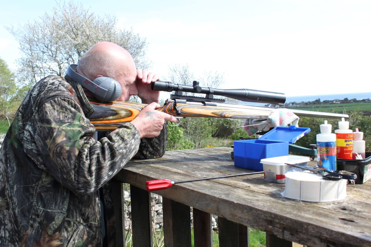

Here is some eye candy for those of you into gun porn bling.
My mate Winston wrestling with the eye relief, he reckons that this rifle would be a b*****d to carry on the hill. :lol:

I had the same issue with bolt removal on my barnard actioned .284 untill i realised that the bolt handle screws off.
