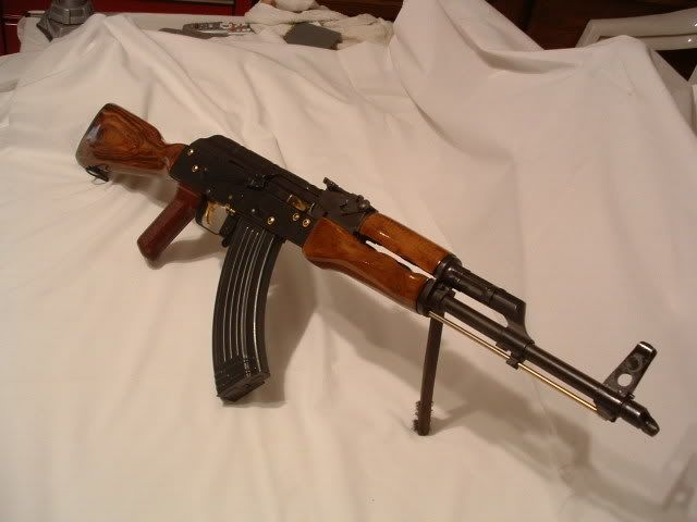

A few years ago my Neice's husband wanted me to build a AK as a birthday present for his father in law (my older brother)
How could i not?
I said" buy the parts and I will build you a AK the likes of which the world has never seen."
After a week, I brought this out of the gun werks.
Yes it is 24kt gold plating.
Last AK I ever built, How could I top that?
Re: Gun Porn
#2 Post by ovenpaa »
:goodjob:
When you say build can you tell us a bit more about the process?

Re: Gun Porn
#3 Post by Christel »
Aw gawd, you are doing this on purpose :shakeshout:
Very very very VERY nice :goodjob:
Did he like it?

Re: Gun Porn
#4 Post by Burner »
He loved it
